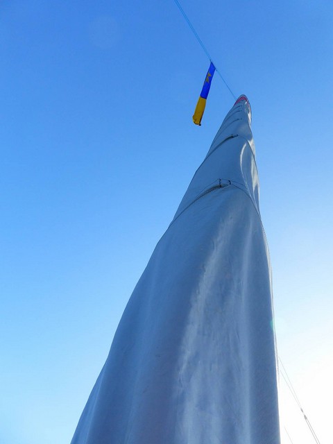

Une photo du bord d'attaque de l"aile de Tystie ............ :? David Tyler semble s'en satisfaire ...

"I'm cruising again, and can give a first sailing report (de David Tyler):
Remembering my terms of reference - an easily handled rig for ocean cruising, and cruising to wild places, with all the benefits of junk rig but with windward performance as good as I can get it - I think I'm getting there.
I'm sailing rather closer to the wind than with my "Fantail" junk sail, with good boat speed. Don't ask me for numbers that would apply to other boats - because Tystie is quite unlike any other boat (except her one sistership), they would be meaningless.
Two days ago, I beat through some narrow channels in the Broken Group, Barkley Sound, with only enough room to gather boat speed before it was time to tack again. I was making 90 degree tacks in 5 - 10 knots of wind, on the GPS track (ie, with leeway taken into account). Pretty good, I thought. Bermudan rigged boats couldn't have/wouldn't have done it.
Yesterday, with 15 - 20 knots of wind, I beat into the entrance to Ucluelet Inlet in the fog, making about 120 degrees between tacks on the GPS in the choppy sea. This is about as good as I'd expect to get, in the conditions.
Helm balance is neutral in about 10 knots of wind, and with a little weather helm in one-to-two reef conditions (that's all the wind I've had so far).
The sail is taking a good shape from the centreline of the luff and around the lee side.
The windward side of the sail, from the luff back to the half way, or widest point, of the nose is tending to collapse inwards, as it did with my previous wing sails. I addressed this in those sails by adding three "riblets" between noses, and it seems as though, if I want a sail that's good to look at, I'll need to do the same again. They probably ought to extend far enough aft to bear against the mast. They can be made from, say, 10mm alloy tube. Will it have any effect on performance? I don't know, though it ought to have, if the first few % of the windward side are in their designed shape.
And finally - most of the bermudan-rigged boats here are motoring a lot of the time. I can't find one with whom I can surreptitiously try to sail alongside. If they're so good at sailing to weather, why don't they do it?"
